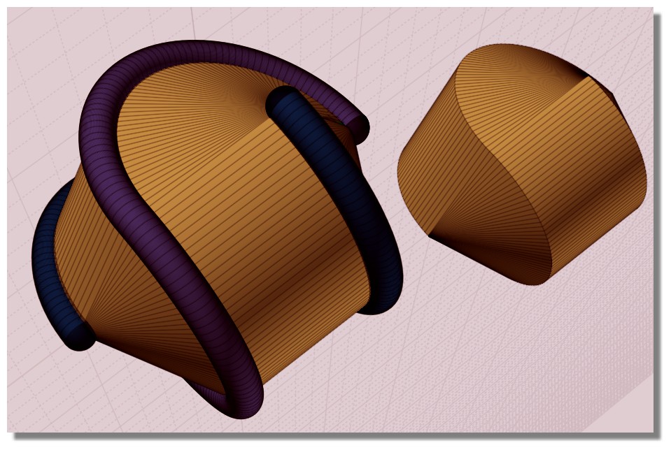

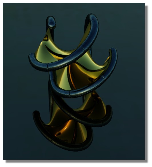

Yes but i was obliged to input a thickness for paint recto verso the surface with 2 different colors! ;)
From: bemfarmer
IMHO, the surface is not a moebius surface.
Attempt at a HexSphericon, as per link attached:
http://www.mathias.org/steve/sphericons/series.htm
HexaSphere03.zip
<< not a Moebious surface
Cool : that i was supposed ! :)
For the Hexasphere there is something curious!
When you export it in OBJ format you will obtain not the clean voulptuous tensile surface shown before the export
but a middle "cubic block" !
So you must Separate it and clean some things for have this cool tensile result!
