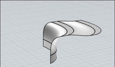

Does it possible to have an "Iso cut" ?
As sometime Fillets don't work maybe that will fine to have an "Iso cut" :)
here i draw the Iso-line(s) then cut the surface(s) by the Iso-line (s)
then Blend
Problem is what part of Surface to cut ?
so when you click the near left edge that cut the "little part" or something like that...
http://moiscript.weebly.com/uploads/3/9/3/8/3938813/iso_cut.3dm

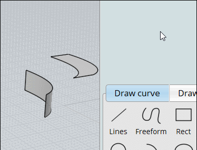

Hi Pilou, there is an "Iso cut" function built in to the Edit > Trim command. It will be shown at the "Select cutting objects" stage of the Trim command if you have selected an individual surface as the object being trimmed:

Perfect for the "one face"! Excellent!
From: Stargazer
Wow! I never noticed that Iso Curve button in the Trim command. Very cool!
Yes and always cool that we can make animation with the Blend function! ;) (or modify on the fly even more times after! (on the same session)
(button "planar Sections is jut shown - not used following)
and for the Planar Sections of this Blend function take a look here!
http://moi3d.com/forum/index.php?webtag=MOI&msg=6790.35 (not shown on the video above! just the button ;) )
PS can be multiple!
