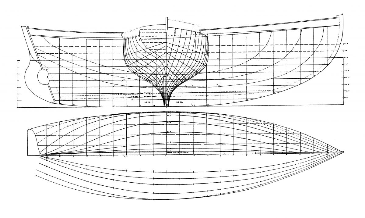

9 Jun 2020   [#77] In reply to [#74]
Yep this serial of videos is very instructive how is made a wood boat! !
(i am on 20/73...; )
And Albert Strange a cool artist and Yacht designer!
https://en.wikipedia.org/wiki/Albert_Strange
Hull Plan of Tally Ho from another cool site : https://davestallyhomodel.blogspot.com/2019/02/the-first-steps.html
Amazing stuff!
