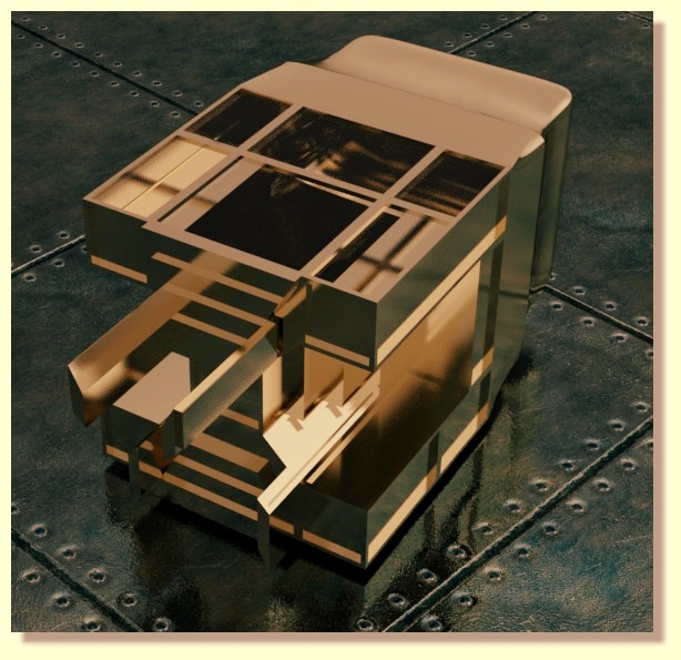

Just for the fun : use the SsPlit function for speed modeling! :) (P = Ssplit)
The first time click an edge - Mirror enabled
Move & Create 2 lines on the volume
Click an edge
Right Click for recall the Ssplit function
Click an edge
etc...
then extrude Positive or Negative faces
and as always it's difficult to select "tiny faces" - Select a Big face then Little face(s)
then re-click the Big face for deselect it! ;)
and extrude them
etc...

Little correction of the selection of faces of a complete volume!
When you select directly the All volume the SsPlit don't work!
so
I said Separate All then SSplit : that work!
But you can also make that! :)
Select one face then select All and then Ssplit that work also!
(because Moi memorize the nature of the selection made by the first selection: point, edge, face,...
Maybe more speedy in calculate than "Separate"! :)
(negative extrude dig up! :)
