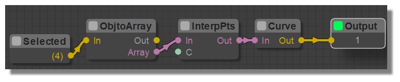

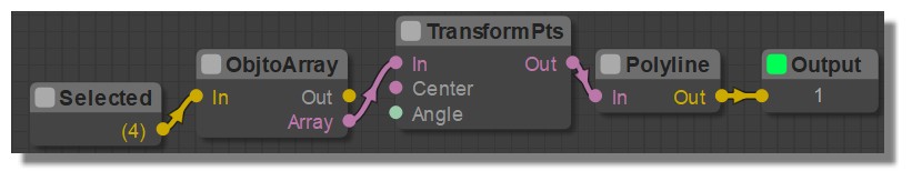

4 Sep 2019   [#92]
Sorry I am in total foggy mood! :)
Say I draw 4 Points : how to transform them in Polyline or Curve ?
(or Maybe Nodes Polyline or Curve is not made for that ?
My OutPut stays desesperately "orange" even with hundred of tests/errors! :)
PS and how gives the good order of them ?

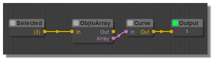

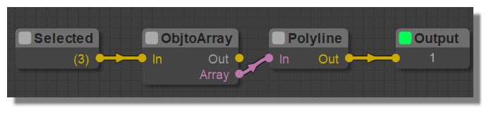

4 Sep 2019   [#93]
OK I have the curve! :)
It's more problematic for the Polyline : problem of order of points!
4 Sep 2019   [#94]
OK I have the Polyline also! :)
Maybe Node "MovePoint" will be more simple with dx,dy,dz =0 than TransformPts
Not sure if all that is very orthodox but that works! :)
Order of points is good when you click one by one for select them for a few selection
Many more problematic when you have hundred of them!
4 Sep 2019   [#95]
Very very mysterious!!!
Now that works like that must be! No need to insert an additional Node! :)
