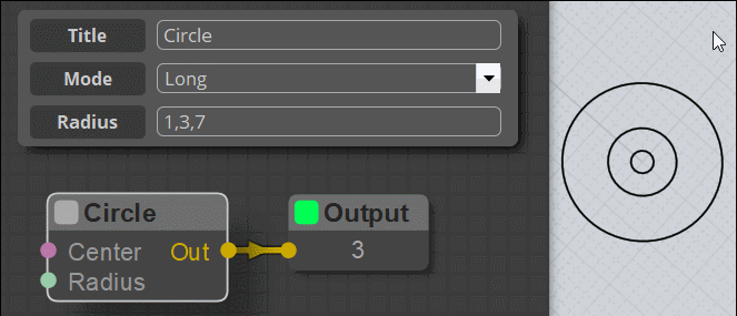

Added Circle Dia   (English)
Curiously there is not Input inside the Info Panel!

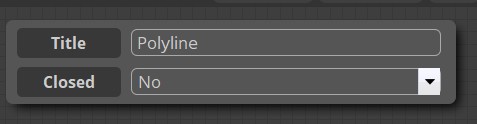

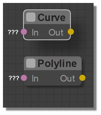

I am blocked with the Nodes Curves & Polylines for Input datas ! ???
If you have some lights about that! :)
From: wayne hill (WAYNEHILL5202)
Look at the curves.js file for the geometry definitions.
// Curve
function Curve()
	this.addInput("In","pointarray");
	this.addOutput("Out","objectlist");
	this.properties = { mode:["Curve", "Curve", "Interpcurve"], closed:["No", "No", "Yes"]};
// Polyline
function Polyline()
	this.properties = {closed:["No", "No", "Yes"]};
Wayne
From: James (JFH)
The 3 colours of wires and connectors (inputs & outputs) represents the 3 data types:
GREEN = number data (numbers or numArrays)
PINK = point data (points or pointArrays)
YELLOW = objects (curves, surfaces or bReps)
So Curve & polyline nodes inputs are PINK and hence point arrays (minimum length of 2)
Hope this makes sense.
PS Keep up the good work.
Yes I am totally agree with you but the problem is that i don't find the good "native" Nodes for that! :)
(simple way like that or more complex)
I must miss something trivial!
From: bemfarmer
So Green inputs may have default values in the info window(?)   Pink pointarray inputs do not have such default values in the info window (?)
Also Vertikal should be changed to Vertical :-)
Vertikal is Max ! ;)
<< Pink pointarray inputs : what is the name of this node (if it's a native one)
Polyline has no case for input list of something

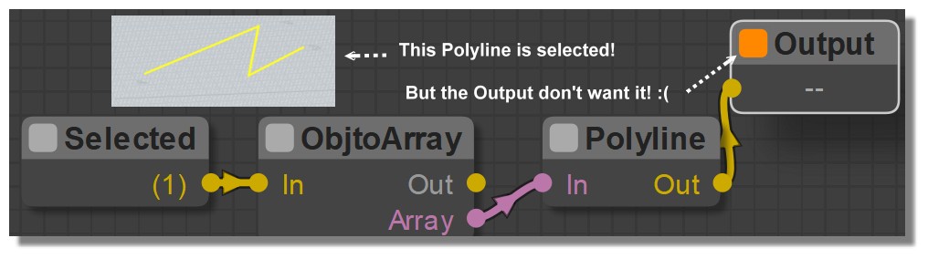

Say I draw 4 Points : how to transform them in Polyline or Curve ?
(or Maybe Nodes Polyline or Curve is not made for that ?
My OutPut stays desesperately "orange" even with hundred of tests/errors!  :)
PS and how gives the good order of them ?
