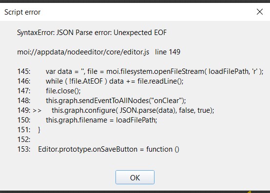

Don't know if it's a bug ?
When I press Load in the NodeEditor , and then press Cancel in the Windows of download file
i have this... (so I select no file)
26 Jan 2020   [#387] In reply to [#386]
Same error is encountered here.
I vaguely recall it occurring several months ago (?)

27 Jan 2020   [#391] In reply to [#386]
Hi Pilou
>> When I press Load in the NodeEditor , and then press Cancel in the Windows of download file i have this... (so I select no file)
I fixed this bug. Thanks
27 Jan 2020   [#392] In reply to [#391]
Excellent! ;)
