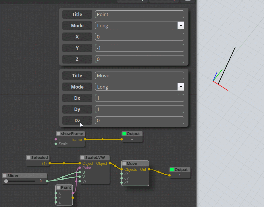

Hi Pilou,
Regarding the point input to ScaleUVW:
For example, with your .nod file:
Place a physical MoI point at say (-5, -5, 0 ), for a reference marker.
Wire a point node, set to ( -5, -5, 0 ), to the pink input to ScaleUVW.
Place a circle at the origin, Top View, say radius 0.5.
Have slider vary from 0 to 10.
Select the circle, and Update Selected node.
Run the node.
Vary the slider.
Slider at zero places the circle at ( -5,-5, 0 ) with radius of zero.
Slider set to 1 leaves the circle at the origin, with radius 0.5.
Slider at 2 places the circle at ( 5, 5, 0 ) with radius of 1.
Slider at 3 places the circle at ( 10, 10, 0 ) with radius of 1.5.
etc.
21 Oct 2019   [#356] In reply to [#355]
Thx but i have a result a little different!
X & Y are negative at the screen! Does this normal ?
And for slider at 2 I have not your "5,5" but "2,2" :)
if i don't wire the Slider on scaleUVW (UVW regulated at 2 from start) size don't move!
But the big problem is the negative one!
Send the .nod for see if i have a bug inside the function itself...
EDIT: OK I have found : I must don't wire the POINT! :)
So I have exactly your result! :)
Rest only the negative points for the direction of moving : why we must input (-5,-5) and not (5,5) ?
21 Oct 2019   [#357]
In fact seems Point is a sort of action Point...
playing only with this Point + Move we can obtain a sort of Mirror! (and of course ScaleUVW)
(but always headaches for find directly the good result! :)

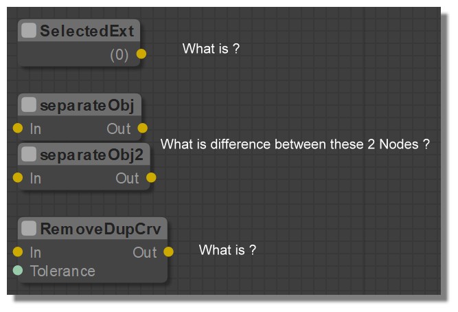

SelectedExt has the code of Selected, with addition of "order" choice, and a bit of code to handle the choice.
I did not delve into the code too much. Formatting of the original Selected has multiple code lines lumped together, which makes it harder to read...

yes but have you an example of what take advantage of use it :)
like
Creation order
A = Cube
B = Sphere
C= Cone
Selection by click
B = Sphere
A= Cube
C = Cone
But now how call object (1), object (2), object (3) for make something with ? (following the method choosen)
the array functions ? Maybe ObjtoArray i will try that!... :)
I don't see also an Array Curve Node?
From: Karsten (KMRQUS)
22 Oct 2019   [#362] In reply to [#361]
Hello Pilou,
it's useful for e.g. Loft. If the order of the curves not like you want;-)
Hope that helps!
Have a nice day
Karsten
22 Oct 2019   [#363] In reply to [#362]
Maybe also the node "Idx Select" +"Obj to Array" can maybe resolve some of my problems! :)
