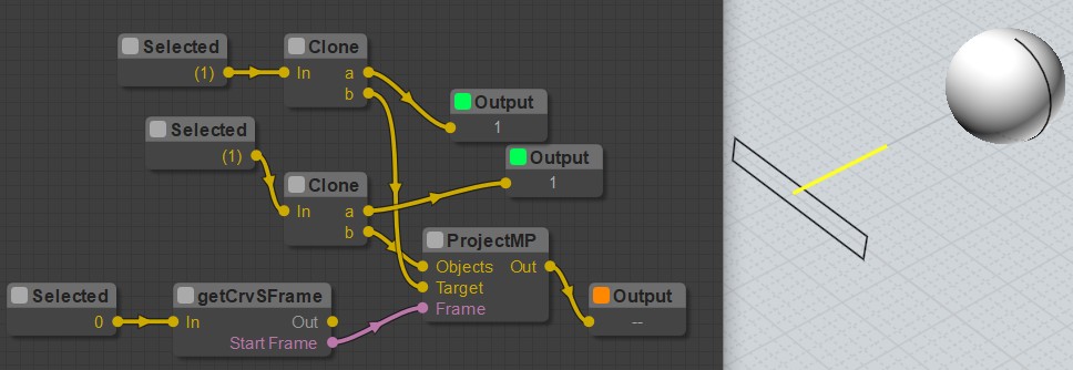

Hello Pilou,
you can't define a plane/Frame with identical/colinear vectors. X-direction and y-direction have to be different by Default;-)
Have a nice day
Karsten
<< X-direction and y-direction have to be different by Default;-)
I miss the principal trick! :)
But what is indicated the direction toward the sphere ?
Here i want the "Y" ...this frame is an headache for me for the moment! :)
Orient node can be helping ?

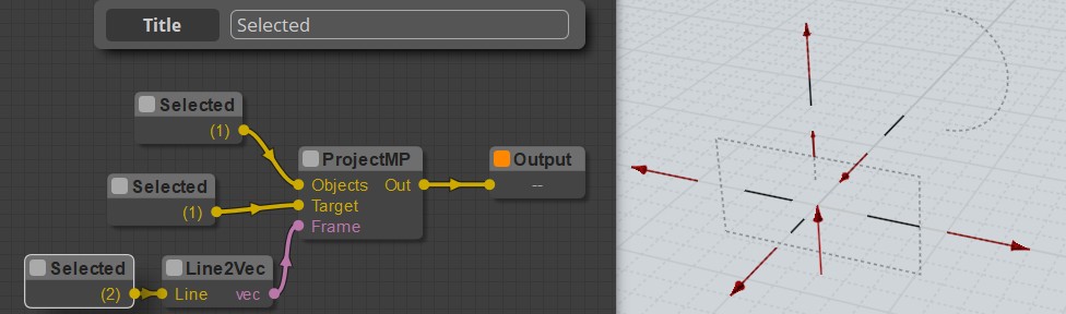

From: Karsten (KMRQUS)
Hello Pilou,
first: Points in the nodeeditor are also Frames. A Frame has an origin that is also a Point. In Your example X-Axis is the x-Axis. Now define a line in the shown z-Axis as your y-Axis Input. The resulting z-Axis is like your y-Axis - only in the wrong direction - but that doesn't matters I think.
That's Basic vector math. The z-vector is the cross product of the x and y vector.
Have a nice day
Karsten

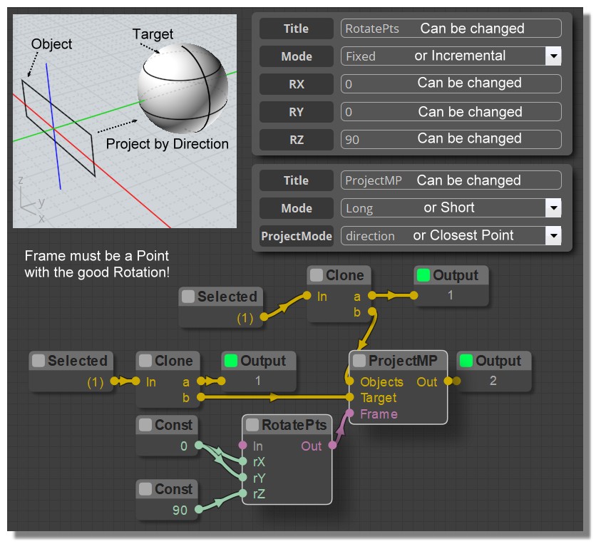

From: James (JFH)
To set the direction in projectMP, use rotatePts like so.
(image a bit blurred in compression: rY value = 90)
Hope this helps
Many thx! So cool the result seems effective!
And seems an only one Point is sufficient as "Frame" if i good understand! :)
Maybe in the futur when i will be more experimented all that will be more automatic!
And maybe find a mnemotechnic trick for have this good point following the position to manage!

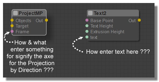

Now rest the ultima thing for the text2 : can we input text (not "number")(from a file maybe cvs(?) in the text input circle button?
Here the Rotation Point must be an another axe! ;)
