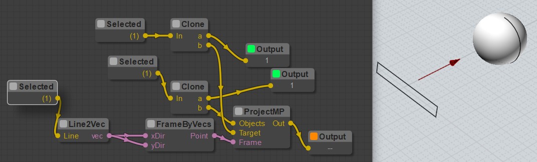

A more classic example of RailRevolve! ;)
I take a Point as center of Axe : seems vertical by default!
Wished a simple method for input a "frame" inclined!
Network Node
English
http://moiscript.weebly.com/construct2.html#network
I am perplex : i don't find the trick for input the right thing inside the Frame!
How do you process?
this Selected --ObjtoArray --Frame like following don't work! :(

From: bemfarmer
For Frame, try vector\FrameByVec.
Right hand rule with two orthogonal vectors yields z axis.
I find a lot of the point characteristics confusing:-)
Lots of luck with SplitPts and PointExt.
There are also Infos/ShowFrame
and Points2/getCrvSFrame

About vectors not better...but it's my lack of use and what is a vector inside Elephant! :)
This really draw only the "red ARROW"! Pity because that was cool for draw a vector! :)
I always don't know what the "Frame" is really wanted!
( seems I have a line selected in the good direction)
