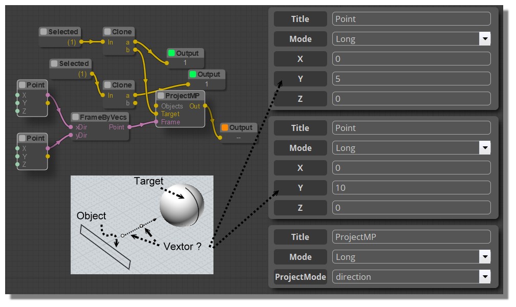

7 Oct 2019   [#282] In reply to [#281]
For Frame, try vector\FrameByVec.
Right hand rule with two orthogonal vectors yields z axis.
I find a lot of the point characteristics confusing:-)
Lots of luck with SplitPts and PointExt.
There are also Infos/ShowFrame
and Points2/getCrvSFrame
Text2:
https://moi3d.com/forum/index.php?webtag=MOI&msg=7777.936

About vectors not better...but it's my lack of use and what is a vector inside Elephant! :)
