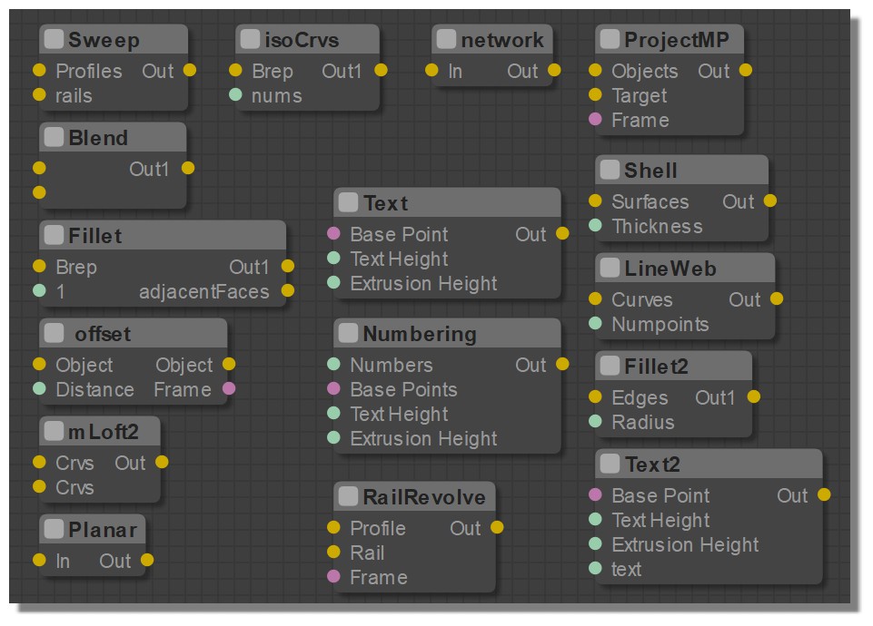

Fillet2 ?
Text2 ?
Ok for the Fillet2!
It works exactly like the Fillet above! :)
Rest the Input text!

From: Finema
Hi Pilou
BrepnameSuObjects is useless with Fllet2
Cool so more speedy! But seems you can't select edge(s) wished so a "global fillet ? ! (and I see you use the French version! ;)
And about the Construct2/Fillet how do you manage and use the adjacent Faces ?
If before i select Face(s) against Edges i have no result...
If I select only Edges I have no result...
If I select Edges + Faces I have no result...

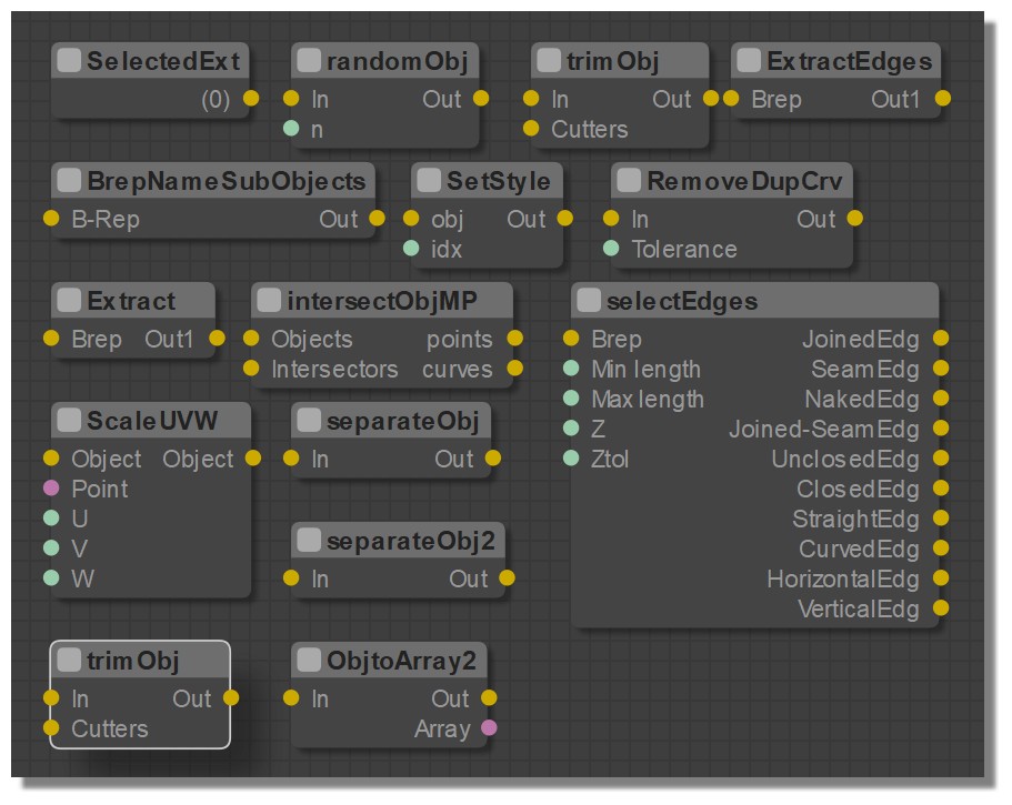

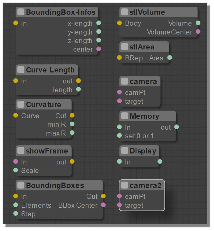

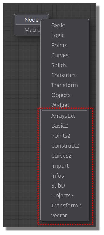

Not Native Nodes By Sections ...that is some frightening! :)
English (Native and not Native)
http://moiscript.weebly.com/all-nodes.html#allnodenonative
Array Ext
Basics2
Points2
Construct2
Curves2
Import
Infos
SubD
Obj2
Transform2
Vectors
