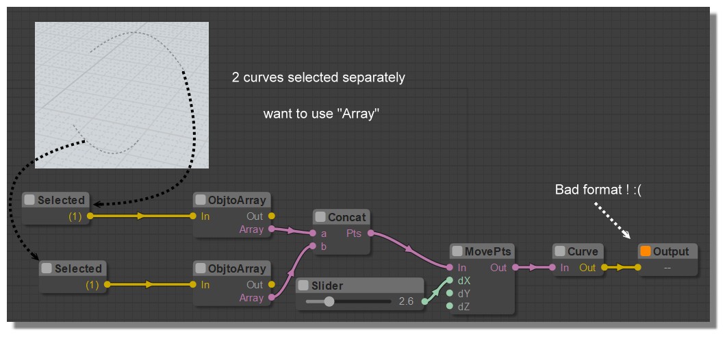

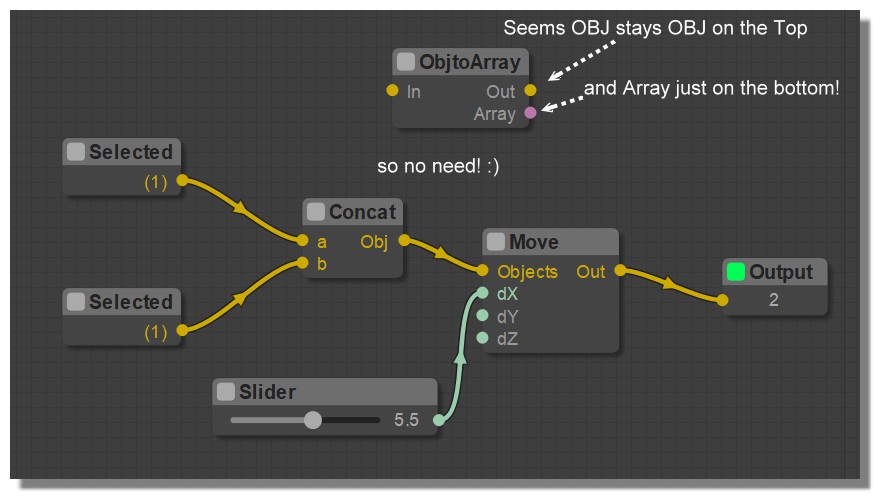

Hum hum ... am I right? So that I made above is not totally adequate! :)
The ObjtoArray don't change all the OutPut...
19 Sep 2019   [#204]
I miss another important concept! :)
19 Sep 2019   [#205] In reply to [#204]
19 Sep 2019   [#206] In reply to [#205]
... (always 2 separated curves selected)
That i find difficult is to pass from a color link to another color link...so useful is the general screen of nodes...
Not yet found the trick...i have now only one point against a complete curve(s) wanted! :)
...or more simple how to obtain Points from a curve selected ? Clone To Pts seems a good candidate but...
Ok I find "how to obtain Points from a curve selected" but it's not inside the Native Nodes! :(
...and always not that i want: result of the join of something coming from the pinky "array" here more than one point (with the native nodes)2 curves from the
or better the rescue of the 2 curves from the Concat of the pinky "array" (always with the natives nodes)
