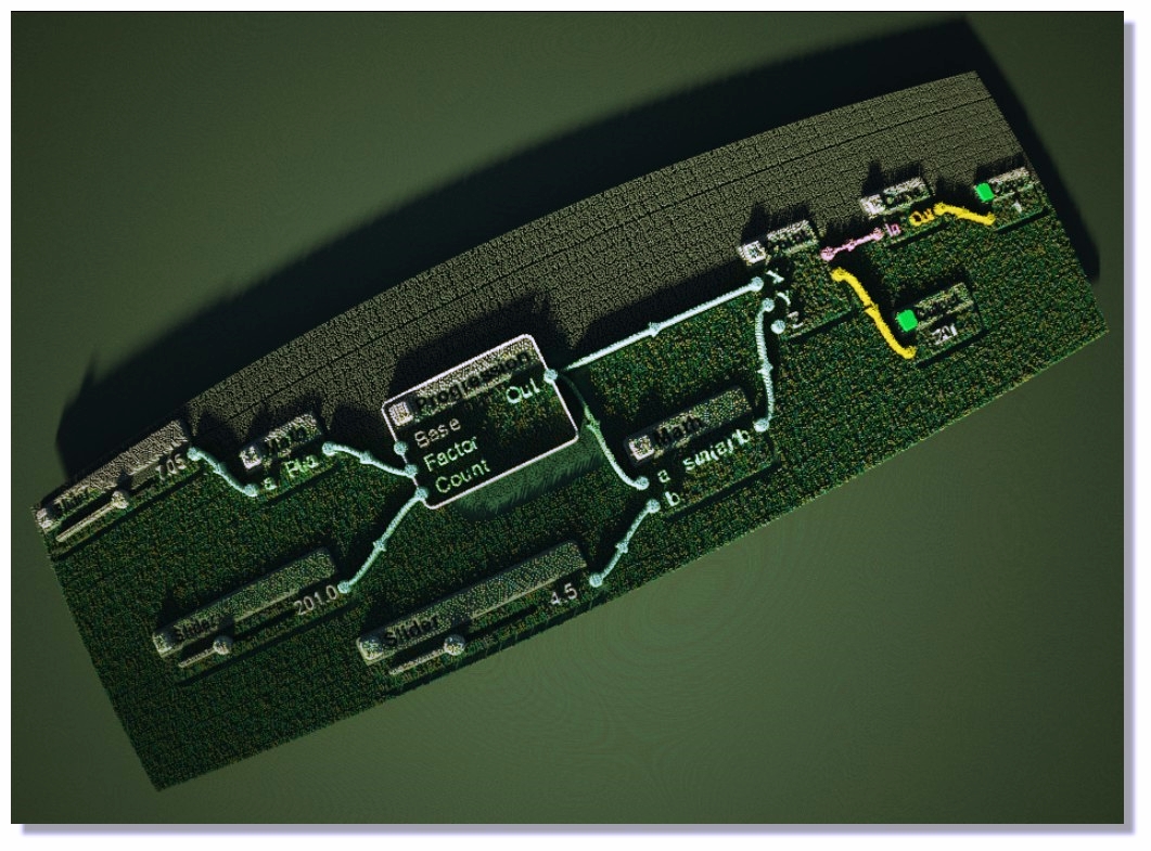

18 Sep 2019   [#191]
Length Node (English French)
18 Sep 2019   [#192]
Missing of training :)
Wanted to draw a simple sinusoïd with the Basic / Math (not with the Point / Math)
Not yet found an elegant solution!
18 Sep 2019   [#193]
Progression Node (English French)
http://moiscript.weebly.com/basic.html
From: Karsten (KMRQUS)
18 Sep 2019   [#194] In reply to [#192]
Hello Pilou,
You need the second coordinate. Make points and use curve:-)
Have a nice day
Karsten
sinwave.nod
18 Sep 2019   [#195] In reply to [#194]
@ karsten
Very elegant and the trick was the big conceptual paradigma "Progression Node" that I totally missed!
and Bravo only use the Native Nodes!
and less intimidating than this one!
So I can make the "Math" node now after study in depth for no deviant art! :)
18 Sep 2019   [#196]
18 Sep 2019   [#197]
Math Node (English French) Many Thanks to Karsten!
