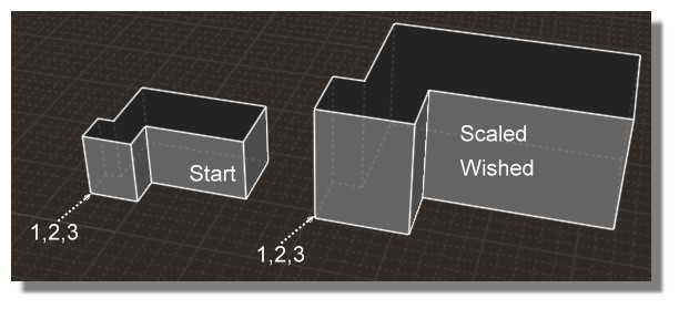

@James ...something like this! Target of the scaled volume(s) has the same x,y,z than the start one!
because all your examples used a figure who have yet a "center" inside their definitions so more easy to manage! :)
There is not such thing inside a simple complex volume(s) selection except maybe the Bounding Box...but I wish a specific x,y,z point :)
(maybe your last example will give me some ideas ...
Maybe JitterPts Node who has a Scale item inside can also make something...
other thing : Why colors of links have changed in your new personnal design UI of Node Editor?
@Bem ... yes i see the theory but can you put a little example with the nodes Math concretely for see how input formula in a Math node! :)
Ok find my wished Scale! :)
Start Object is selected at the good X,Y,Z position! (1,2,3)
The trick was to put 1,2,3 inside the Node Point (but even seem the "Frame" works only with 2 x,y positions ? )
and 1,2,3 inside the Move Node! :)
so some relatively easy :)

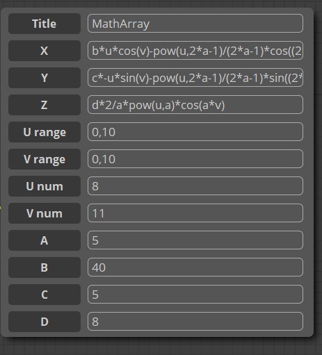

If for the normal Math Node I can understand where put some formulas, I am more perplex for the MathPts Node! :)
I need some examples for unblock the situation! :)
From: bemfarmer
The X, Y, and Z can be functions of u and v.
So X = sin(u) would be one example. Y = cos(v), Z = sqrt(something)...
Or more complex equations.
Check out the Macro's, which are likely from James:
mobius, offsetGrid, sineSurf, waveSurf, quadSpheres.
It would be nice to find a really cool example.
Maybe a curvy surface in 3d...
From: bemfarmer
Here is an enneper example by James, posted by Pilou :-)
https://moi3d.com/forum/index.php?webtag=MOI&msg=6521.37
James link to the nod file EnneperScaling.nod:
https://moi3d.com/forum/index.php?webtag=MOI&msg=6521.34
Note the complex formulas.
I think this one is an excellent example.
A surface in formed in 3d space.
The iso linecurves can be viewed with the MoI iso command.
Many Thx! Ok All is clear now! :)
Just a little last question : does it possible to increase the size of the Info Pannel? (seems not)
because biggest formulas are truncated at the screen!
