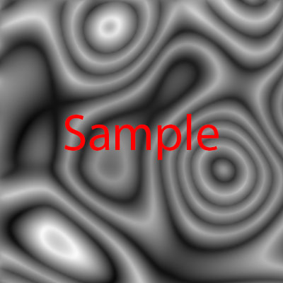

23 Mar 2019   [#6]
first I used Houdini Apprentice to generate the displaced noise mesh on a planar surface.
Then I brought the mesh into ZBrush for a bit smoothing. After that I generated a normal
map from the mesh and used it in Knald to generate a height map. Once you have a height
map you can then simply use the free program Zsurf to generate the NURBS surface. In MoI
I extruded the edges and once I had the sides I trimmed them and added a planar surface
to obtain a solid. The lines you see in the solid are from trimming, so that one can use
the separated surfaces for colorizing.
23 Mar 2019   [#7]
P.S. This workflow could be drastically shortened if Texture Generators could generate
those noise textures on the fly, but when i did a Google image search for my texture
it found nothing which could lead to such a software … :-(
sample
