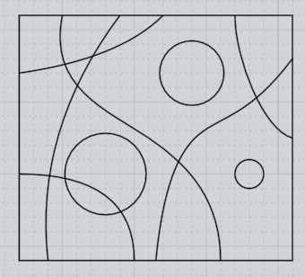

And this by Max Smirnov ? Random curves (there is also Distort Curves)

Cheers.

Here's an little example of what you can do with curves too, looks close from your last post.
For every points of the grid, I compute the distance of the closest point from every curves ... then I remap this distance with my own profile, and use the result as displace (elevation).
Displace strength, max distance search and profile options are in the pink node.
