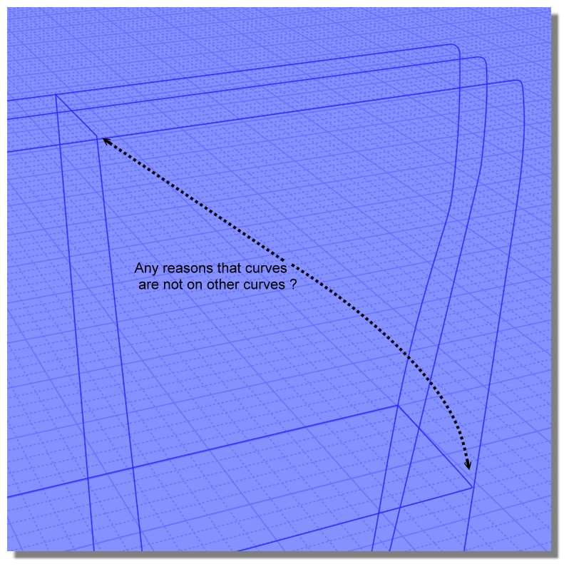

From: Bravlin
Its strange. Ctrl+C, Ctrl+V creates pretty messy and dense curves. It also creates lots of them not the one closed curve.
From: Barry-H
Hi Bravlin,
Select these edges each end copy paste and join.
You then need to extend the lines I showed in the previous post.
Join with lines to complete the Boolean profile.
Barry
.png)
Hi Bravlin,
Often times curves from intersections can be pretty dense. It's normal and not usually a problem since you won't normally be control point editing such curves.
You'll get one curve for every edge that was selected. Alternatively you can directly use Edit > Join on multiple selected touching edges to make a closed curve result without doing Ctrl+C/Ctrl+V first.
