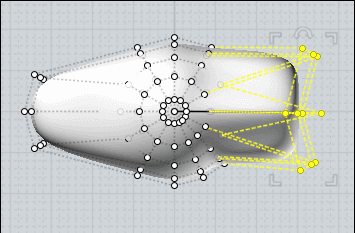

Q_03: Hope it's not too much if i ask 2 questions one day. Got another shape-question.
We discussed earlier the network-operator approach. And for smooth shape it works great.
But today i tried to use this approach to construct this shape. This shape a bit more complex but still have rounded sides.
I spend half of a day in attempts to create clean shape and generate plenty of guesses in a process.
So if it possible can you share some guides rules to network operator according this shape.
I attached project file that have 2 layers.
On layer "L_09" i trimmed profile curves in direction of middle line, and on layer "L_10" i trimmed it in axis direction.
But i guess since we have shape that do not have equal sides its not an issue.
In result we should have something similar to that shape.
MQ_005.3dm
13 Feb 2019   [#39] In reply to [#38]
Hi Bravlin, sorry I'm not fully understanding your Network question. Is it that you would like it to make a shape as if it had already filleted edges in one single application of Network?
That will be difficult since Network builds one single surface result (which will be split up at any sharp corners) and it is difficult to make a single surface that goes through a localized significant change in shape like a fillet transition.
In general it's best to use Network to build one smooth surface which has a regular 4 sided boundary. It isn't generally very workable to try and build what should be a multi surface model out of one single Network.
Over time I have noticed a kind of recurring pattern that people with a poly modeling background really like to draw all the 3D edges of their model and then want to use Network to fill it in. But with NURBS modeling usually it is better to make extended pieces that do not have pressure applied to their boundaries, that's how you get high quality surfaces. Then some of your final edges come from intersections like trims or booleans rather than trying to do it all with directly constructing surfaces to an irregular boundary.
From: Bravlin
14 Feb 2019   [#40]
Michael thanks again for your answers. Hope i not too annoying you with this those nooby questions.
Such small fillet is not required, its better if rounded edge would have wider angle. It would be hard i guess to mimic that fillet result via Network operator.
I just want to understand the logic and rules that network use. I can't understand what exactly cause the problem with this shape.
- Is it a center spot that i used to divide edge profiles on equal parts.
- Or its an angle that i choose to divide profiles.
- Or maybe the different number of points in rail profiles.
- Or its maybe a sharp points in curves.
- ... etc.
I now know how to build rounded shapes like those that we build in Q_01.
But for more square like shapes that also have smooth edges and tilt (so they not easy to trim or extrude) i still don't know what to do.
The trim approach and extrude creates sharp corners and i need this shape as one piece(or 2 mirrored pieces).
The result shape on a picture is a combination of extrude, trim and loft. But if you look on it, shape lack of continuity and smoothness on edges.
That's why i want it in one piece. I know that for such shapes it would be easier to make it in polys and import to moi.

14 Feb 2019   [#41] In reply to [#40]
Hi Bravlin,
Well a few different things - too much variation in shaping between stations, like you have tight bends in the corners and then those collapse down to a pole point for the next station. There shouldn't be so much variation between profiles.
When collapsing down to a pole it's best for the shape to resemble a circle before the pole, something more like the attached file. But overall it's not a feasible shape to try and do with one single surface with poles.
Little skinny pieces are because of sharp corners not being aligned to the other direction's curves:
Can you post the model file so I can get a better look at it?
You build an extrusion that is straight and has flat ends initially, then introduce tilt by cutting it with a side profile, something like:
MQ_005_2.3dm
BravlinNetwork1.jpg  BravlinNetwork2.jpg  Bravlin_boolean1.jpg  Bravlin_boolean2.jpg  Bravlin_boolean3.jpg  Bravlin_boolean4.jpg
