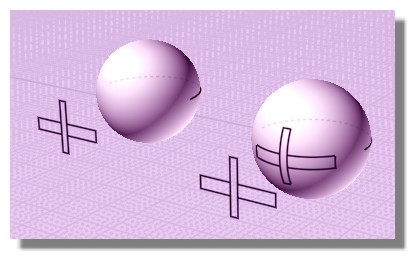

A simple Projection ?
i don't know..., when creating a sphere like you did and with a pattern,
i select those and in node editor the run button is greyed out, after
loading the node file... :-(
I have the latest node editor version installed, in MoI v3.1.
