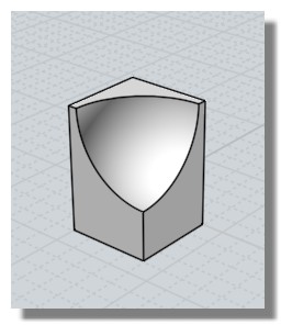

20 Jan 2019   [#54]
For any file stp to DSM
Launch the DSM V4.0
Load the file ".stp"
And make the little tricky create "Sphere 3D" and unlock on the top arborescence! (as seen some post above)
That's all! :)
the file step created in Moi3D
Inside DSM

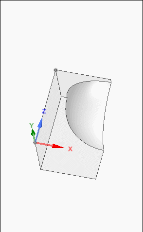

3 Mar 2019   [#61] In reply to [#60]
Hi JerryBerry, your Converted.sat file comes in ok with the current MoI v4 beta, you can get it from http://moi3d.com/beta.htm .
One thing that's a little odd is the units are in meters so the object is of a small numeric size. You may be able to get it openable in MoI v3 if you can get the .sat file to be generated using an older version of the .sat format like version 8 or something like that. That will then make the .sat file use more general NURBS surfaces and curves for things rather than newer specialized entity types.
Here's what it looks like loaded into MoI v4:
