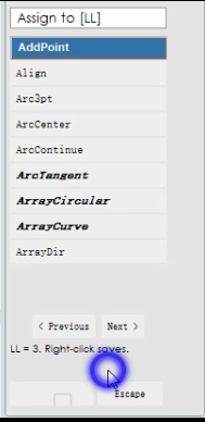

keygroups,无法保存组,popout功能和commandpalette <yourkeygroupname> modal功能在v3中无法使用。(Keygroups, Failed to save group, the popout feature, and the command palette <yourkeygroupname> modal feature are not available in version 3.)
这张图的蓝色光圈证明我点击了鼠标右键,但没有反应,CommandPalette.keygroups.txt也无法生成。
(The blue halo in this image indicates that I clicked the right mouse button, but there was no response, and CommandPalette.keygroups.txt could not be generated.)
https://i.imgs.ovh/2026/06/14/70dac466f5b0d41e96110b651e92edaa.png
在v4,v5中如果CommandPalette.htm,CommandPalette.js位于\MoI 4.0,5.0\commands时popout,command palette <yourkeygroupname> moda功能显示为12014.25正常窗口大小但空白,但group功能能够正常使用因为CommandPalette.keygroups.txt能够正常生成,因为在v4,v5中有默认的\AppData目录。
(In versions v4 and v5, if CommandPalette.htm and CommandPalette.js are located in \MoI 4.0,5.0\commands, the popout command palette <yourkeygroupname> moda function displays as 12014.25 with a normal window size but is blank. However, the group function can be used normally because CommandPalette.keygroups.txt can be generated normally. This is because there is a default \AppData directory in versions v4 and v5.)
在v3中,首先弹出的窗口不是正常尺寸,我想这是因为版本差异,所以popout以及相关的command palette <yourkeygroupname> modal功能不好在v3中实现。但是命令编组功能应该是基础功能吧,如果没有的话,脚本就只能搜索命令和翻页了。
(In v3, the first pop-up window is not of normal size. I believe this is due to version differences, so the pop-up and related command palette <yourkeygroupname> modal functions are not necessary in v3. However, the command grouping function should be a basic feature. If it's not available, scripts can only search for commands and page through.)
https://i.imgs.ovh/2026/06/14/dbb606897ae62a35396ba4d21e64fd8e.png
From: stefano (LIGHTWAVE)
14 Jun   [#32] In reply to [#31]
hi suiyan,
This current tool wont work properly in v3
this tool is exclusively tested in v5
