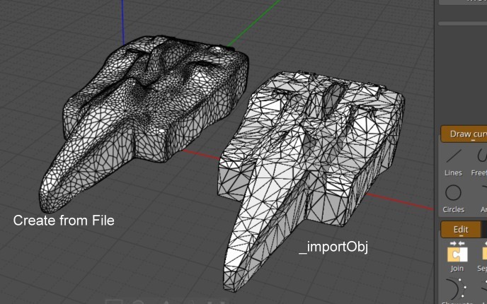

From: Matadem
14 Mar 2025   [#75]
Good day.
I've been playing with Nvil for a few months now.
And the creator has posted allot of needed video's on youtube.
When you get used to this it is very fast...the model below can be done in 10 minutes. and I am not even good.
Question what are the best practices to import this model into Moi?
Export as obj and Importobj? is there anything I need to look for ?
Tnx!
14 Mar 2025   [#76] In reply to [#75]
Hi Matadem,
You'll want to export the level 0 base control cage, without any smoothing applied.
Export that to .obj format and then in MOI use SubD > Create > "From file" .

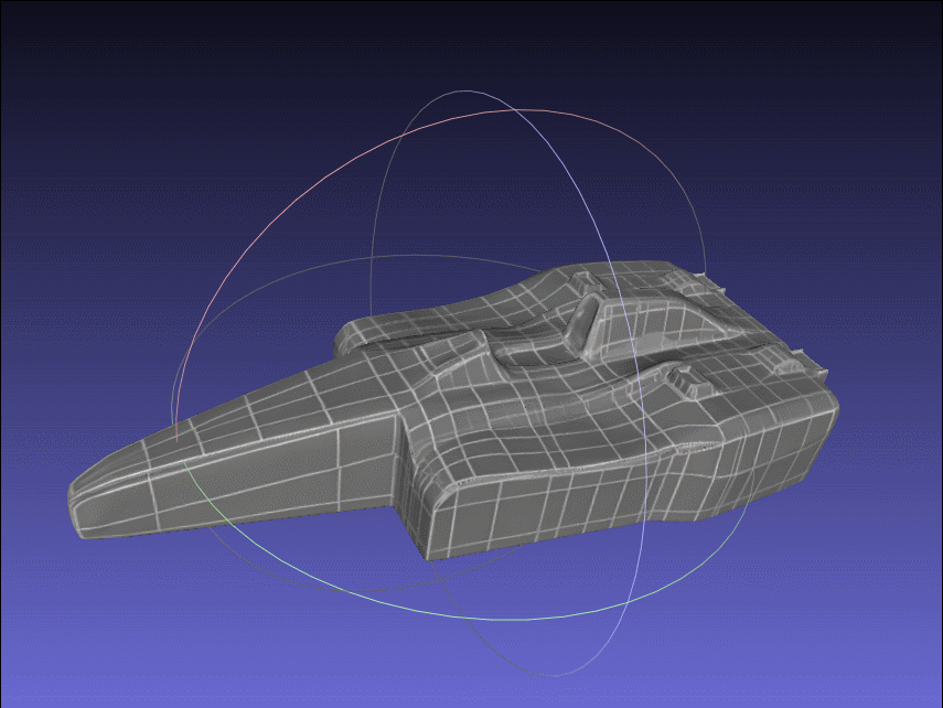

15 Mar 2025   [#77]
in case of no 3D file but only a photo and depending of what do you want to make! :)
You can use the free Vizcom
with this image
you obtain a 3D file format GLB
use the free 3D Builder (inside Windows) export as OBJ
use the free Mesh Lab for Decimate quadrangulate etc...
export as OBJ
Use the Max Smirnov _Import OBJ to import inside MOi
So maybe make another regulate inside MeshLab! :)
Tripo ai gives a terrific 3D result from an image!
with more decimated and free Instant Meshes
From: Matadem
15 Mar 2025   [#78]
Micheal
What do you mean by export the level 0 base control?
Great info Pilou!
15 Mar 2025   [#79] In reply to [#78]
I believe it's no Subdivided! ;) (Level o)
15 Mar 2025   [#80] In reply to [#78]
Hi Matadem,
The lowest density one before any subd smoothing has been applied.
The one that is called the "control cage" in this video:
https://www.youtube.com/watch?v=ckOTl2GcS-E

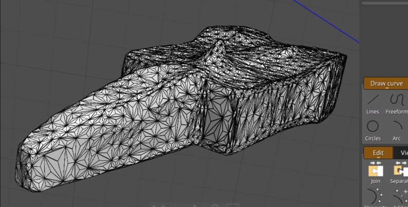

15 Mar 2025   [#81] In reply to [#77]
Hi Pilou - what you show there are examples of what you want to avoid doing.
Like this result:
That comes from applying sub-d smoothing onto a control cage that has not been set up for subd modeling, it's just triangles.
The result will be extremely overly dense and will likely contain a lot of bumps and undulations in it.
It will be difficult to use something that messy to do further work on.
So I'd recommend not doing any of what you show there, sorry!
