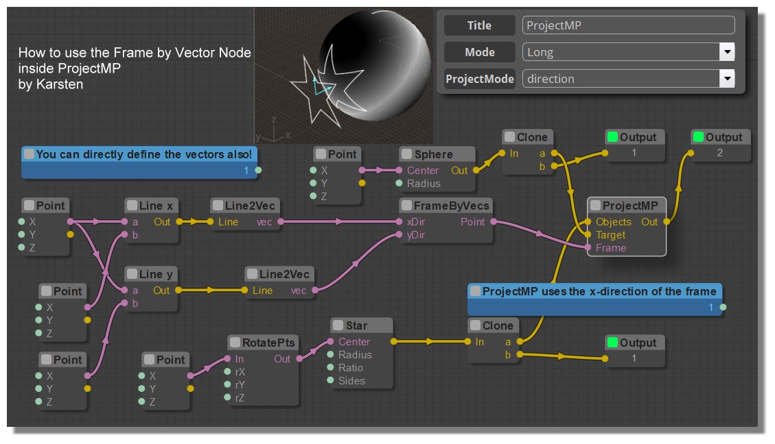

I understand my error : i had read Line2Vec like "Line to Vectors" so completly missed the "FrameByVecs" !!!
So believed that only one line was sufficient...
I must past this on my screen computer! :)
And will added of course in no time here! :) http://moiscript.weebly.com/construct2.html#projectmp
